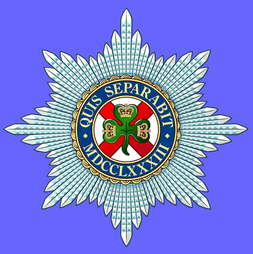

Re: Advice on making stickers for dice
Like this ? (Minus the Watermark) Image
The design wouldn't be a problem and the transfers would just need to be sized to fit onto the flat space on the dice. Super easy...barely an inconvenience :D
The only slight complication I can see is that, because of the white in the centre of the design, you' might need to use white transfer paper. That would mean you'd need to cut around all of the "twiddly" bits or you'd end up with a white border.
An alternative would be to use clear transfer paper and underpaint white where you need it to show through.

So what you'd want is something like this:
The blue background would be measured from the die face photo and would be a close match. For 12mm dice I'd set the artwork (spots patterns and star) at 10.5mm sq, with a 12.5mm sq blue surround.
The badge and spots would be printed on white decal paper, as Paul suggested, with the blue surround to match the dice.
To avoid getting a white edge you'd cut through the blue surround to the star/spots. That's normally not good, because some sealants don't penetrate the ink fully, so the cut exposes the ink and it will dissolve when you wet the decal.
So, after cutting the star out you need to run a brush, loaded with a clear, non-water-based sealant, around the edge of the cut, to seal in the ink.
The other option is to deliberately leave a white border as a sort of frame around each face.
PS the star comes from Wiki and is the work of The Hon Joshua Wood, CC BY-SA 4.0, https://commons.wikimedia.org/w/index.p ... d=46844370

Spanner wrote: Thu May 02, 2024 2:21 pm
True, Paul.
If you can get the blue to match that looks good. :)
I think the faces on round cornered dice are almost circular so if you changed the frame to being circular you could probably enlarge the badge size too. (Relatively)

That's fairly easy with a decent graphics programme, even a freebie like paint.net. Use the colour sample tool to read the dice colour in the photo and set that as the background colour for the spots and star. It may not match 100%, but it should be close enough.
Paul wrote: Thu May 02, 2024 6:45 pm I think the faces on round cornered dice are almost circular so if you changed the frame to being circular you could probably enlarge the badge size too. (Relatively)
Good point. You could make the blue background a circle for that. However, having to cut out six decals each for a lot of dice may be taking the idea towards the "Too Hard" basket.
